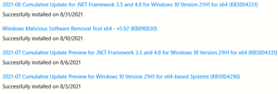

The one that seems most likely would be the Logitech HIDClass - 1.10.79.0 as the HIDClass includes the keyboard driver.  Would "Uninstall updates" remove the offending driver without otherwise leaving the OS hanging?
The only other updates in the History since August 1st are two Quality Updates and the following:
