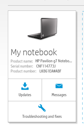

Hi,
Try performing a diagnostics test on battery and ac adapter (under heading power) to see if they have any problems. Here is link to HP diagnostics document:
https://support.hp.com/rs-en/document/c03467259
Can you also provide the exact model of your g7 notebook so that we can see if there are any Bios updates.
https://support.hp.com/za-en/document/c00033108
Let me know,
David
This is the product number of my HP G7 please help
