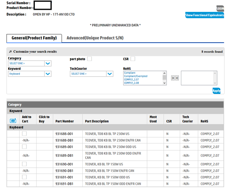

I have an HP Omen 17t-an100 CTO (Model number: 2XP11AV) that needs a new keyboard- the D and E keys are failing, and I suspect several others are beginning to go. I took it into two separate HP Service Centers, both of which refused to fix it, for various reasons, but essentially I have to buy the part myself if I am to have any hope of fixing it. If I buy the part, they'll still install it (for the low, low price of $200 on top of the $200 part, which is a lot higher than the $250 quote for fixing the keyboard originally! Whee.)
So, I need to discern which of the 2 keyboard replacements to buy off the HP Parts Surfer for my particular laptop - photo attached. I don't have an optical drive, so it's just a question of the 150w or the 230w. Does this refer to wattage- the obvious "w"? How can I find this out? I did the HP Hardware Diagnostic Utility thing, but it very helpfully provides information about almost every facet of my hardware EXCEPT my keyboard. How do I know which to purchase?

That part is "not orderable in the HP Parts Store", which is why I asked here. I'd seen the service manual before, this is the third time I've read it. It does say the bygone part is 230W on the Parts Store entry though, so I guess that's the iteration of the other thing that's compatible with my computer. It would be much more useful if the service manual had been updated to reflect the part number changes, since I had dead-ended there before.
