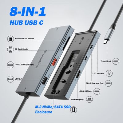

I bought a HUB that has all the latest specs (USB-C 3.2 Gen 2 / Thunderbolt 4 / PD 3.0, etc.).
So, as usual I connect my HP Charger to the PD 3.0 Port of this HUB, then connect the HUB to the USB-C Charging Port on the top-left of my Spectre 14-ef0000 (2022).
But despite detecting my external HDMI Screen, my external Drive, and so on... It DOES NOT charge the Spectre.
I tried the same HUB with my other HP Spectre X360 13t-AW000 (2020), and it does charge it.
All my USB components Drivers are up to date, I even updated the Firmware of both the Spectre and the HUB.
Hub Brand & Model : WavLink WL-UHP512S  (with the Realtek RTL9210 chip which is known for its efficiency and stability).
PS: It charges just fine with the USB-C Power Adapter directly connected to it (to the USB-C Charging port)

Hello Banhien and thanks for chiming in.
Of course I checked.
Everything's compatible with this Hub. It's basically the same specs as HP Universal USB-C Multiport Hub
- It gets up to 100W from any USB-C Power Adapter that's connected to its Power Delivery Port 3.0.
- And delivers up to 87W to the any Laptop with a USB-C Charging port.
And the Spectre X360 14-EF series only needs 65W... Even charging it with a 45W power adapter works fine! Hence why it doesn't makes sense.

This is it!
OMG Banhien you have a real talent for problem solving. Thanks to the Tech Specs PDF you sent me, I realized something:
Most (if not all) of HP's Docks power through at least 100W. I first thought it was an overkill, as the Spectre 13t runs fine with 45W, and my current 14-0000x also runs fine with just 65W.
Then it all made sense: the Docks (whether HP or 3rd Party brands like the one I have) need way more than 65W to power both the USB-C / USB-A Ports AND the Power Delivery 3.0 to the Laptop.
Hence my Dock why it was working fine with my old Spectre 13t because it only needed 45W, but my 14-0000x needed way more than that.
So I went ahead and bought a USB-C Power Adapter that delivers 90W (i.e. the XITAIAN 90W USB-C which is quite affordable), and bingo: the HUB was charging my Laptop like a charm!
