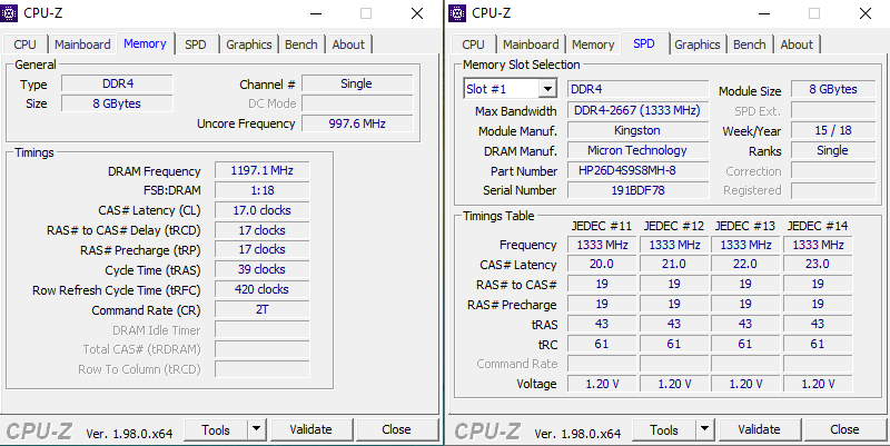

Hello, thanks for the reply. The one you shared appears to be CL19 and as far as I know, the current one is CL17.
Wouldn't this be a problem?
I would run CPU-Z to check the actual latency your memory is running. CL=19 is pretty standard for DDR4-2666 SO-DIMM. I also think your laptop actually runs the memory at -2400 speed so it would be a different latency. HP notebooks generally run memory at very conservative timings. If you find you need CL=17 modules we can help you find one I think. All the ones I am finding are CL = 19.
That was my surprise as well. It seems my memory runs at latency 17 though.
Check the image please.
Runs at 17 latency at DDR4-2400 speed. At 2666 speed (if it could do that) latency would be 20. The DDR4-2666 with CL=19 latency would run CL=17 latency just fine at 2400 speed.
Thanks for the info. Then I will buy the one you suggested. Thanks for your help!
