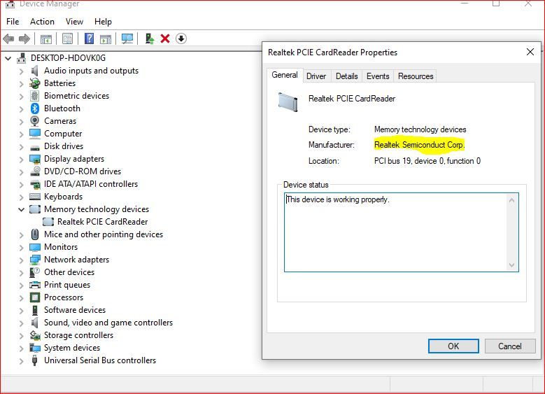

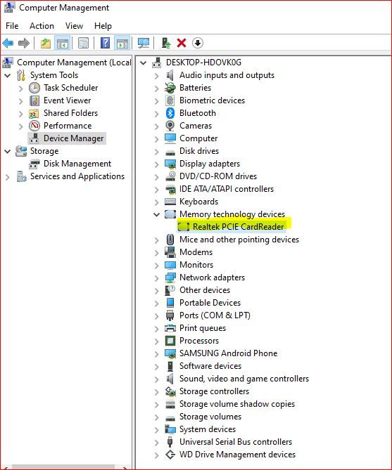

But when I let Windows download and install this update shown below, the driver of this device got installed.
However, CardReader is still not detecting any MicroSD adapters inserted into the slot of CardReader.
I am still stuck on why the device manager shows, under the device status, that device is working properly. But when inserting any MicroSD adapters having SD card into the slot of card reader, I didn't see anything being shown or detected by Windows.
Btw. Could you please let me understand why, in the device manger, although the Realtek Card Reader device isn't being detected, the status is stated with the following text:
"This device is working properly."
