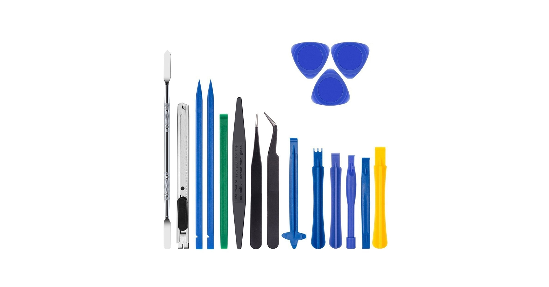

Maybe you can use a guitar pick to get it started and then a more substantial item to separate the bottom cover.
Do you have any old credit cards?  Those make pretty good pry tools in a pinch.
Otherwise they sell notebook pry took kits online.
https://www.amazon.com/Zacro-Professional-Non-Abrasive-Spudgers-Anti-Static/dp/B01F52ZPBQ/ref=sr_1_1...
Thanks for the help sir..i did manage this however when i go towards the edge the clip manages to slide out. Also would using a metallic spudger help?2BADDF26-04AC-4ABF-94AB-83F337666C1A.jpeg
It might, but those can damage the plastic.
