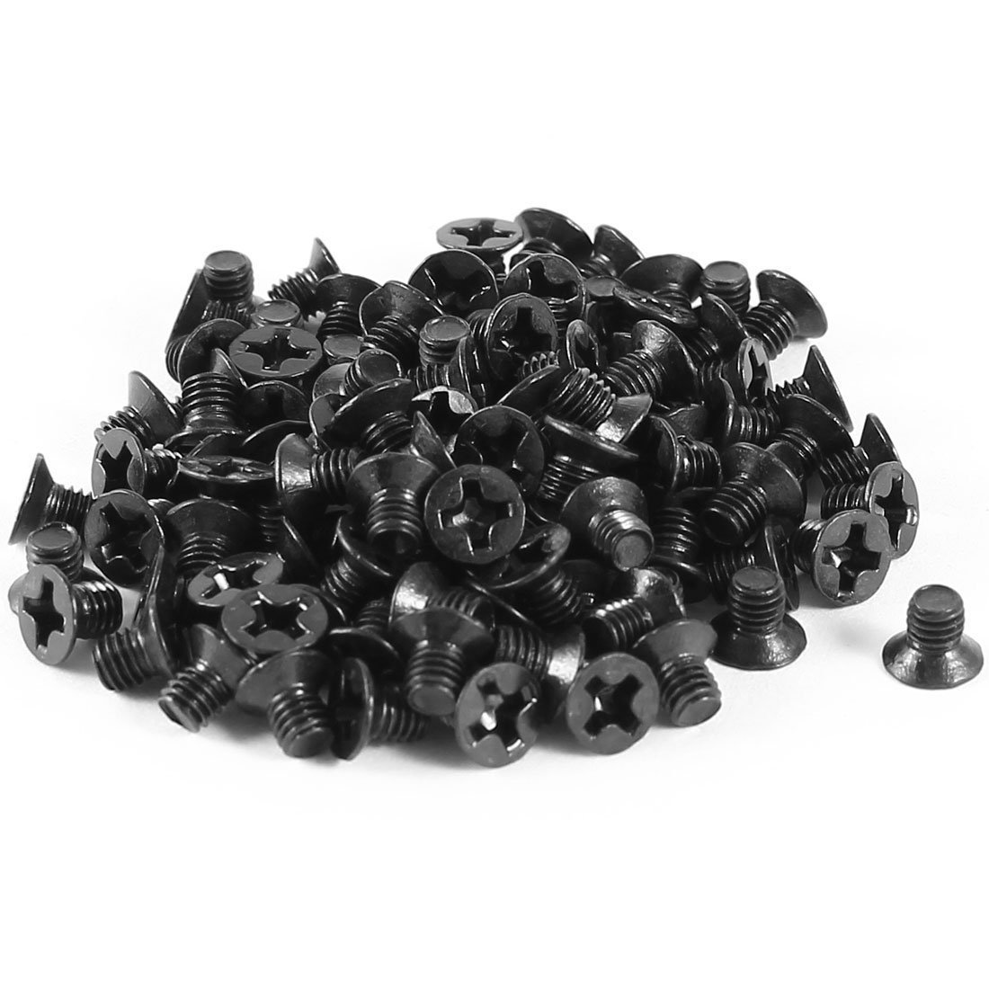

I provided a link to the Service Manual in my first post and directed you to the pages that show how to remove that square thing. You just need to have him put a hard drive in that case and bolt it in there with 4 hard drive screws. On further review, you may need to get 4 thin-headed laptop hard drive screws but those might cost a dollar or so.
Like the above screws.
https://www.amazon.com/notebook-computer-Internal-Mounting-Seagate/dp/B0168H0JSG/ref=sr_1_1?ie=UTF8&...
