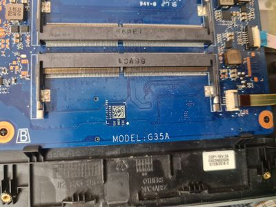

Hello. My hp laptop have problem in mainboard northwest chip and need replace it. Where i can find mainboard that hp confrim it? I need a new mainboard no stock mainboard please just new.
Help me please
Also where find part number?

I believe that you mean PCH (platform controller hub) chip.
The northbridge chip, not northwest chip was on some old school motherboards.
I will take a look and see if I can find the part number for you. G35A is a good part number. I do not know where you would find it in Europe.
This is the system board.
http://www.ascendtech.us/hp-15-ay-pavilion-15-bc-15t-bc-mboard_i_mbltph856678601.aspx?agent=froogle
Try the HP Partsurfer. Use the serial number from the bottom of the laptop case.
https://partsurfer.hp.com/partsurfer?searchtext=W6Z09EA&searchby=product
If you can find the information on the PartSurfer that is about as good as it will get for a confirmation. HP does not sell laptop system boards to consumers as far as I am aware.
