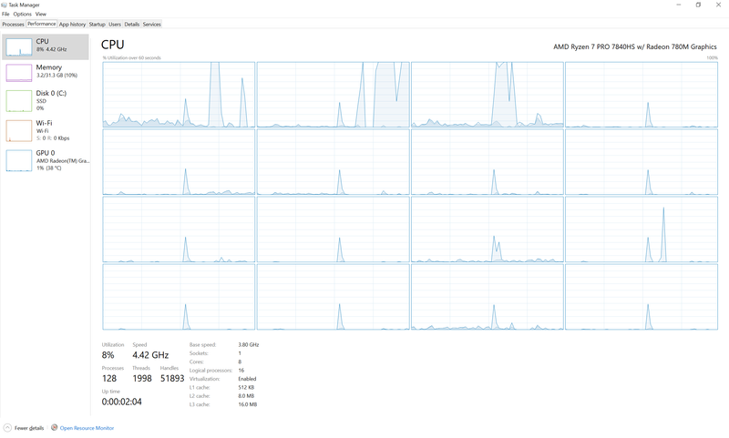

I've got an issue with this laptop. Its CPU, Ryzen 7 7840HS (edit: 7940HS is also affected) never reaches its full advertised boost frequency of 5.1GHz and it's instead limited to 4.5GHz. I've verified the issue under Windows 10 LTSC and Fedora Linux. It can be seen in Task Manager, HWiNFO64 or CPU-Z.
I've already created a support case with HP but I wonder if it's a known widespread issue and there is a workaround.
I've not found any performance related options in BIOS - I'm running the latest available version for my laptop.
Please advise.
I should have called the dedicated business unit support from the get go. I've now talked to a wonderful guy and he told me everything I needed to know.
The issue is being worked on, a firmware fix will be released in "a few weeks". It's not the only issue, so it's taking a little bit more time than usual. Hopefully other laptops will receive updates as well.
