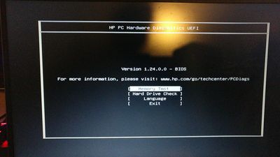

I can hit F2 to enter the system diagnostics screen, and then run a memory test or a hard drive check. The memory test passes fine. However, if I run a hard drive check (quick or extensive), it says the following message:
No hard drive installed. Please check that the power and data cables are connected properly.
Spoiler
If I enter the BIOS setup screen by hitting F10 while booting, it doesn't explicitly list the SSD as a boot device - it's as if there is no device connected at all. Additionally, while this occurs, I cannot access the regular HP diagnostics screen.

Then I tried to test the hard drive (during an episode where the boot device not found screen appears). I was not able to access the HP PC Hardware Diagnostics UEFI screen in your screenshot. When the drive works, I can access that screen. When the drive does not work, I cannot access that screen. Instead, I see the same one from the system diagnostics screen in the error screen:
This is the screen that appears when pressing Esc during boot.This is the screen that appears when pressing Esc during boot.This is the F2 screen.This is the F2 screen.Quick or extensive hard drive check shows this.Quick or extensive hard drive check shows this.
When the hard drive is not having an episode, I am able to access the screen in your screenshot (as I described in my original post), and all of the component tests succeed: Quick Test, Extensive Test, SMART Check, Short DST, Optimized DST, and Long DST. None failed, and I did not receive any error or failure codes.
