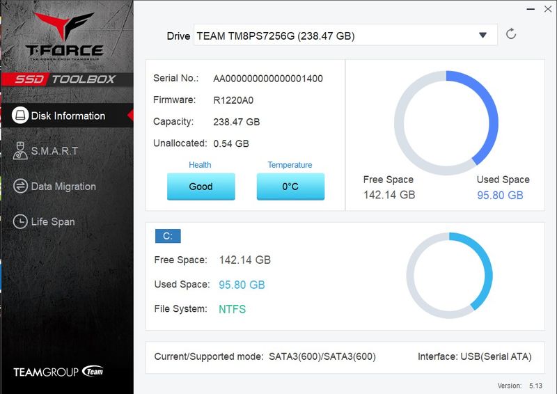

I upgraded my laptop with a TeamGroup SATA III 256GB SSD last month. I checked its benchmark using CrystalDisk that showed a fair speed of 550mb/s read and 450mb/s write speed (listed 550/470) then. Recently the speeds have dropped, lightly in read but drastically in write. I'm getting 480 or sometimes even 450mb/s read speed. Write speeds are the main issue for me here, 20-40mb/s!
The SSD is having 60% free space and the health status is also Good, it is using SATA III 6gb/s port.ssd1.jpgSSD3.jpgssd2.jpg
