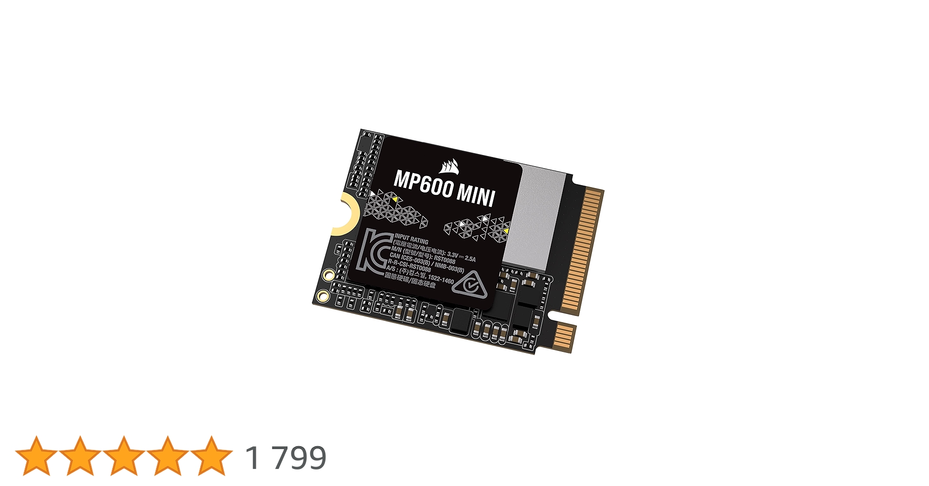

hello, I just bought an Elitebook 650 G9 and I want to add a second SSD drive.
I saw that there was a slot to either put a WWAN module or an SSD drive.
So I ordered an M.2 2230 SSD drive but it doesn't seem to fit.
Could you tell me what type of SSD should I put? Or maybe it is necessary to put a special support?
thanks in advance
Picture of the slot 22477W:
On the motherboard, we can seem 'ssd2' at the right and 'WWAN' at the left
when i try to put the ssd m.2 2230 the mounting hole does not fall on the screw thread. In addition, I have the impression that the connector forces a lot.

08-02-2023 02:31 AM
Hello, thank you very much for the answer.
Regarding the SSD, is the slot an HP proprietary format or can I buy a compatible disk elsewhere?
The disc I ordered is this one: https://www.amazon.fr/dp/B0C28HLKNB?psc=1&ref=ppx_yo2ov_dt_b_product_details

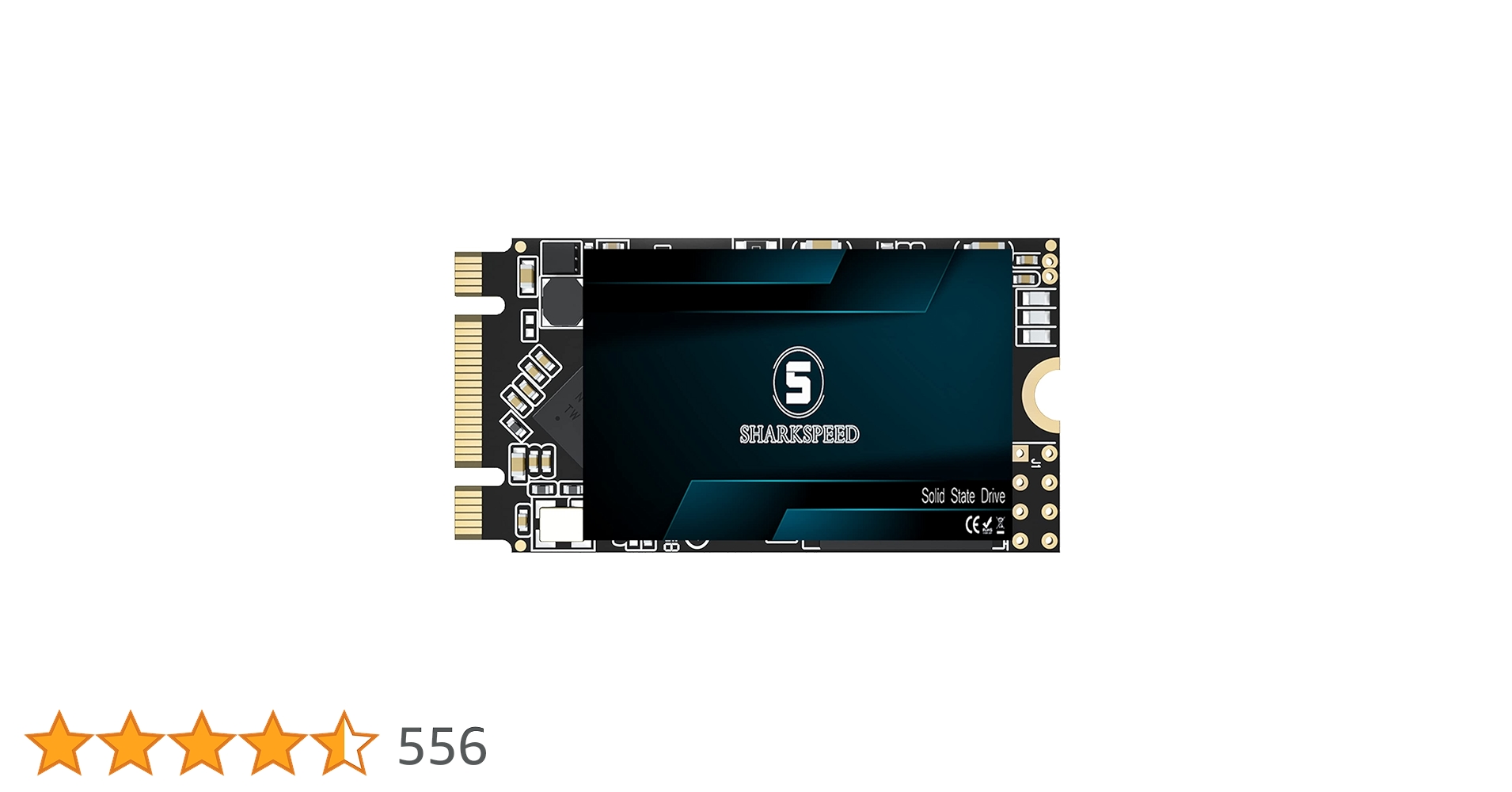

Hello everybody!
Thank you very much for the different exchanges!
I bought the following drive https://www.amazon.fr/dp/B0BW2T5J84 (SHARKSPEED SSD 1TB M.2 2242 NGFF SATA 3 42mm 6GB/s TLC 3D NAND Internal Solid State Drive for Desktop and Laptop PC(1TB M .2 2242)).
It fits perfectly in the SSD2 slot:
On the other hand, Windows does not recognize it at all... And at the BIOS level, only 1 SSD is visible.
Do you have an idea?
Have a good day!
08-05-2023 03:27 AM
I have three ideas:
1.) BIOS/UEFI Settings: Access your laptop's BIOS/UEFI settings by tapping the F10 key during startup, and carefully check if the SATA M.2 drive is enabled in advanced settings or something like that. Some HP laptops allow you to enable/disable specific hardware components, so ensure that the SATA M.2 slot is enabled.
2.) Try Initializing Drive Using Disk Management: Follow the steps starting at timestamp 3:07 in this instructional YouTube video: How to Install an NVMe or SATA M.2 SSD in a PC - YouTube.
3.) Firmware/Driver Update: Ensure your laptop's BIOS/UEFI firmware is up to date from here: HP EliteBook 650 15.6 inch G9 Notebook PC (6H3C7AV) Software and Driver Downloads | HP® Customer Sup.... Additionally, download/run the Intel driver support assistant from here: https://www.intel.com/content/www/us/en/download/18002/intel-driver-support-assistant.html.
Kind Regards,
NonSequitur777
08-05-2023 04:36 AM
It's very strange:
1) I check in the BIOS and didn't see any options for the SSD Storage.
2) For the disk management, the drive isn't see in Windows, so the disk manager didn't show it
3) I already update firmwares and drivers, and i installed Intel Support Assistant, but didn't fixed the issue...
I launch Hardware Diagnostic, and it show me only the first SSD drive....
