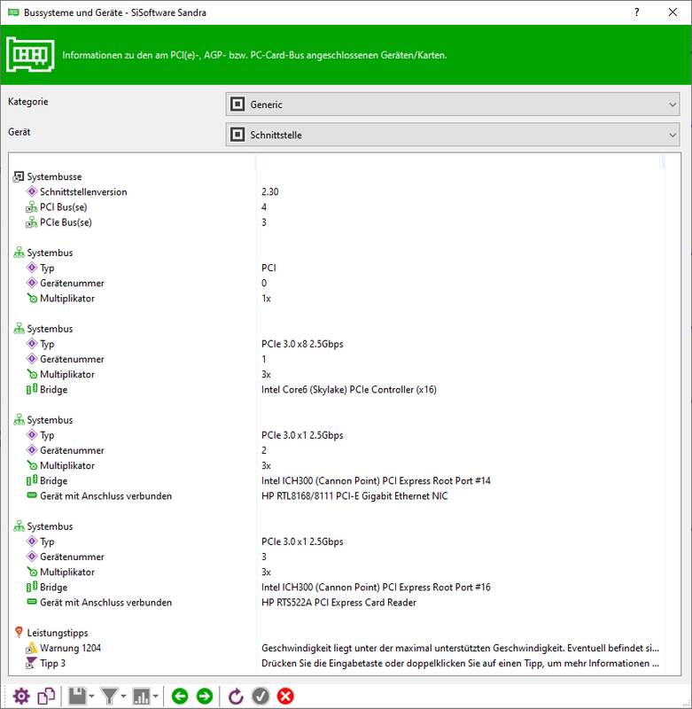

Sisoft Sandra does not find devices on PCIe (#1).
7 REPLIES 7
I suggest using the Device Manager in Windows.
We are here to help, but providing software support for SiSoft Sandra is not exactly on the menu here.

Besides others, I have used AIDA64 and received different results.
HWInfo64 Bus section PCI PCIe Devices rearranged report
