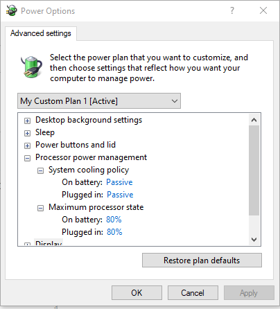

Hey all,
So I can't speak for the 15" inch as that also has a discrete GPU but as for the 13" one the main culprits here are Intel SpeedStep and Turbo boost kicking in/up even for background tasks that we don't care about.
You can disable this by forcing the frequency scaling to a lower number. This means a slower computer but modern CPU's are so fast that you won't notice a difference for surfing and watching movies. The good thing is that this can be managed in the power options so you can easily switch back to "high power mode" whenever you need to.
Steps
1. Create a custom power plan in "Control Panel\Hardware and Sound\Power Options"
2. Click change plan settings and change advanced power settings
3. Change System cooling policy to "Passive" and change "Maximum processor state" to a lower number, like 80%
4. If for some unfathomable reason Microsoft has removed these options from you as well, you can luckily add them with the following regedits and then repeat the steps above.
https://www.tenforums.com/tutorials/107953-add-remove-system-cooling-policy-power-options-windows.ht...
https://www.tenforums.com/tutorials/107967-add-remove-maximum-processor-state-power-options-windows-...
(Special thanks to Shawn Brink)
5. Enjoy your silent HP Spectre x360 13"!
Johnny
