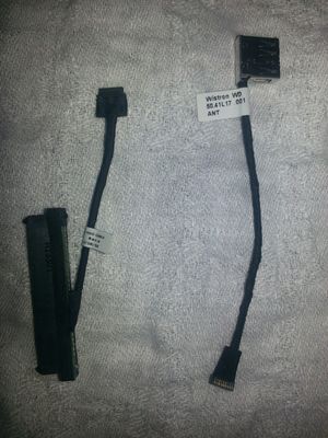

OK, here are the admittedly lousy pics.  Let me know if they don't do the trick and I'll spend a bit more time making better ones!
This is the whole kit.  There are several small bags of screws/fasteners.  The silver rectangle is the hard drive bracket.  The final bag as the two hard drive cables in it.
Overall HDD Kit
Here's a pic of the two cables:
HDD Cables

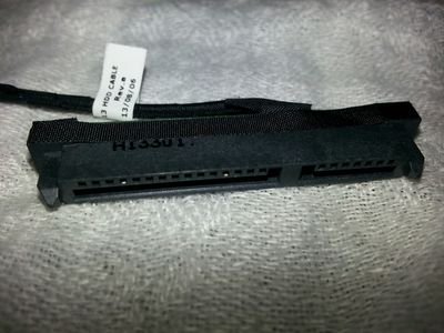

Following are pics of the connectors at each end of the cables:
Let me know if you'd like to see a pic from the manual that shows drawings of some of these parts.  Hope this helps.
Thanks much, here is what they sent me as part of 731424-001.  (Which didn't work).  Can you tell if both ends that connect to the logic board (not the disk drive) look the same? I'll take this off your hands if you want to sell it.  You can private email me with the details.  You're awesome-thx.photo2.JPGphoto1.JPG
Hey Trekker4935, I send you a private email with detailed, higher resolution pics. Btw, I could not see your pics in this post.
Just sent you a private message back.  Couldn't see your pix-must be the weather:)
