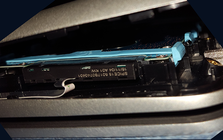

Hi folks. Thanks for posting the solution to this. I was in the process of upgrading to an M.2 when I got stuck at the same step. Glad I found this post pointing out the hidden screws under the rubber footing ($51 for a piece of rubber - ouch). When I try to lift off the rubber strip the adhesive stays put on the case. The rubber strip comes off easily without tweezers. Has anybody mastered to get this off with the adhesive still attached? I'm afraid that pulling the adhesive off will ruin it.
thanks!
edit: I was able to peel the rubber strip a few mms then lift the adhesive off up to the strip, attach it back to strip and continue lifting it slowly off with adhesive attached to rubber strip. No ripping or breaking. thanks again.
edit2: had no idea one could install two hard drives. Now I have a 2Tb 2.5" SATA drive and an M.2 to boot from. Nice.
Once all done you couldn't tell that somebody opened it up.
