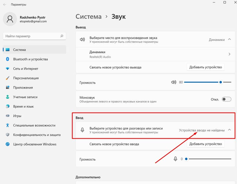

But there is still no microphone . On image belo you can see that there are no Intput devisesproblem2.jpg

The 1022-15E2, I believe is the reason the Microphone isn't working.
I posted a discussion to solve that problem a while back.
Read through it and the solution is toward the end.
Solved: Unkown drivers - HP Support Community - 8671994
AMD Multimedia Co-processor installed but there is no result.
Unfortunately, I don't have any other ideas for you to try.
