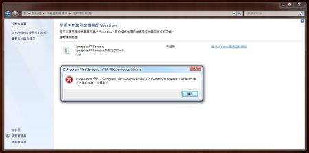

I am currently unable to use my Biometric fingerprint device with Windows.  When I go to Control Panel -> Hardware and Sound -> Biometric Devices - Use your fingerprint with Windows, I get en error popup: Windows cannot find 'C:\Program Files\Synaptics\SynFP\WBF_TEK\SynapticsFMA.exe'.  After clicking OK, the control panel explorer windows then says "The selected fingerprint reader has no management application installed"

Hello everyone..
Error  Message Popup:
