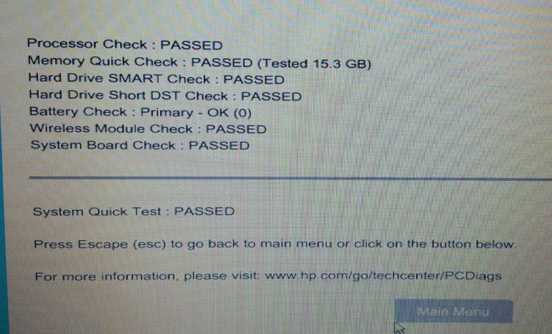

Hello, I just want to say that I was successful in the upgrade of my laptop. Originally had an A8-4500m APU and Insyde F.26 bios before upgrade.
•Hp Pavilion g7-2275dx
•Windows 10 Home
•AMD A10-5750m
•G.Skill 2x8 Gb DDR3L 1866 (16 Gb)
•Insyde F.2A bios (from hp website)
Processor cost me less than $50. It worked with the F.26 bios, but I found the F.2A was the most recent and installed it after installing the A10 APU. I did have to find the drivers for the new processor on the AMD website. Installed both of them and the system is running like a top. Additionally I used DriverEasy software to find any other outdated drivers on the system (12 out dated drivers). Hp stopped providing support a long time ago for my laptop. But everything is as up to date as can be. System is running great. I intend to install a 1 Tb SSD next once I have the funds.  All in all, it is possible to upgrade an old laptop, as long as you are careful taking it apart. It's as good as can get though. If you want better performance, better go with the newer system with the latest cpu's.
