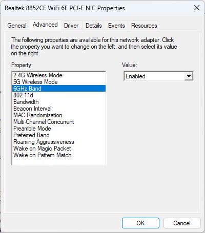

Update:  I got the Realtek RTL8852CE and replaced the Intel AX210 in the laptop.  Powering on, I got BSOD, but the reboot got me successfully into Windows 11.  I installed the driver and was able to connect to my 5G network, but alas the 6G network was not found.  I have installed the latest and greatest drivers I could find.
Any suggestions on I how I can connect to my 6G network?  And if connecting to my 6G network is a lost cause, should I go back to the Intel AX201 card?
You have the latest Wi-Fi driver installed, so unfortunately, I don't know why the card isn't connecting to the 6 GHz Wi-Fi band.
