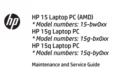

I noticed when I opened the service manual that the model numbers are as follows:
The 15-bw0xx - would that also apply to the 15-bsOxx?
