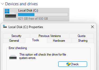

Try running the win10 or 11 disk repair tool to fix it. Select the C drive (or D or E) and then "Tools"

I used the Error Checking tool and it said it found some errors that need to be repaired.
