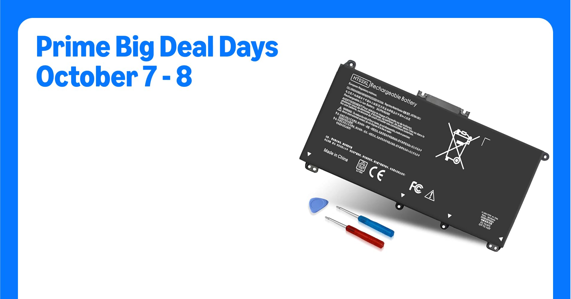

The first thing I would do is replace the battery with  a new one.
The Maintenance & Service guide for your laptop model
http://h10032.www1.hp.com/ctg/Manual/c08289069.pdf
See chapter 3 page 17 Table 3-1 item 18
Description and HP Part Number
(3 cell, 41 Wh) L11119-855
Online vendor source. They state 100% Compatibility
https://www.amazon.com/L11119-855-15-CS0053CL-15-DW0033NR-15-DA0014DX-L11421-542/dp/B08V1DNFFM
