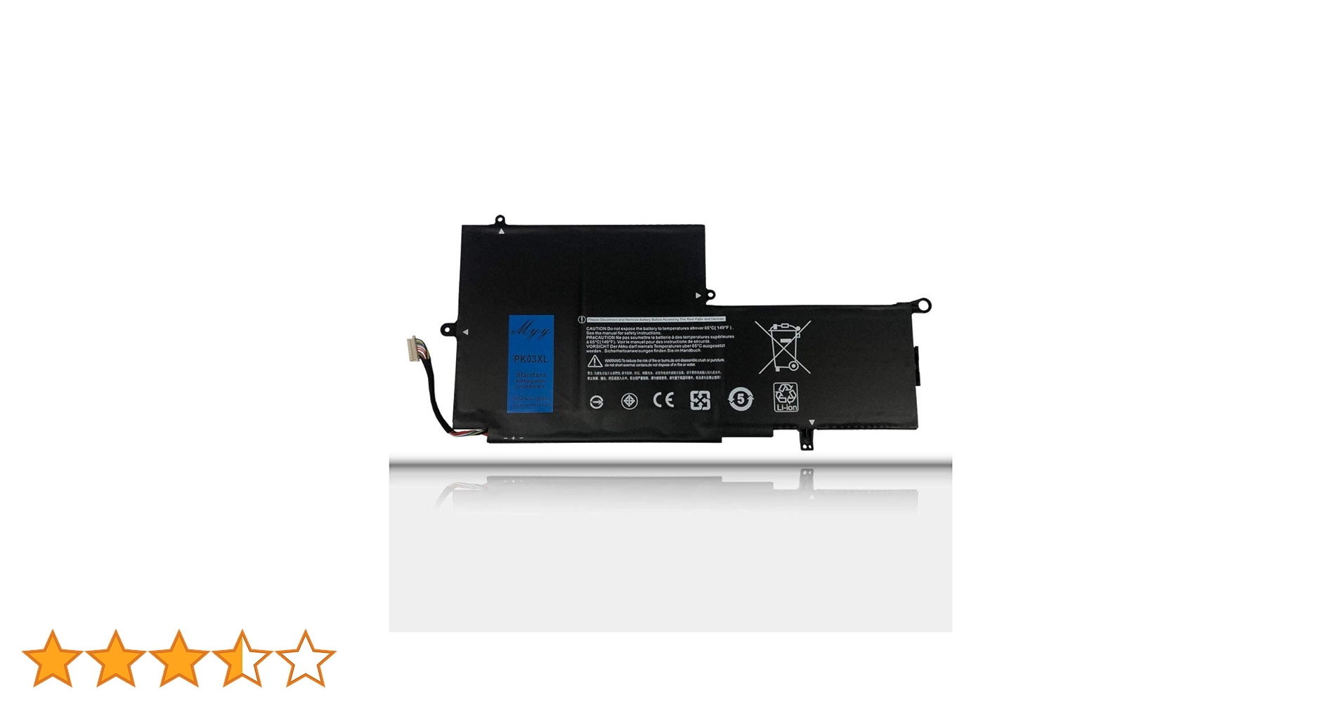

Can we have the model of the laptop? If it is more then 2 years old odds are almost 100% it needs a new battery. We can help you find one and instructions to do the replacement. When the battery is older it may seem to be working OK but if you discharge it too low it will be the last straw for it and it will give up. Cost of a battery is going to be $40-100 depending on the model.

Battery, 3-cell, 56-WHr, 4.96-AHr, Li-ion (includes cable) 789116-005
5 star amazon product:
Post back with any more questions and please accept as solution if this is the info you needed.

Not sure what test you ran. There are a couple different options to test but they all basically do the same thing. If your test could not complete, then I am 99.99% sure the battery is bad and you can't get more certain than that with electronics. The battery replacement is about a 3 on a 10 scale with 10 being replacement of the motherboard. You know how your skills are with a screwdriver and I do not. I just know a lot of end users have reported doing it without any laptop tech experience. A tech might charge you maybe $60-100 to do the work so adds quite a bit to the expense.

I contacted repair shops in Montreal and they quoted much higher rates for the battery but that they would install it for me (however since they didn't order it they couldn't ensure that this was the correct model).
So I just wanted to double check with you that this was indeed the correct battery for my model before I order it on Amazon.
Thanks again for all you assistance.
