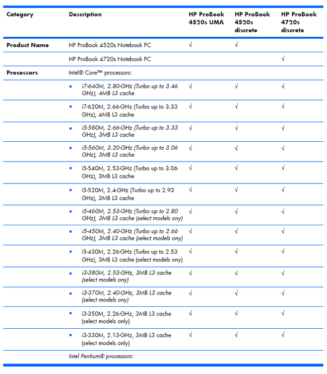

I have a laptop HP Pro Book 4520s. I bought CPU Intel i5 480m. I want to put it in my laptop. will it work? all best

Hi, @Historyman7
The i5-480M processor is not listed as a supported processor.
http://static.highspeedbackbone.net/pdf/HP_BroBook_4520s_4720s_Notebook_PC_QuickSpecs.pdf
I guess the only way you are going to know if it works or not, would be to install it and see what happens.
Here is a side by side comparison of the supported i5-520M processor and the i5-480M.
https://ark.intel.com/compare/52952,47341
I don't see any reason why it wouldn't work, but that is just my opinion.
The thing going against you is that none of the BIOS updates added support for different processors.
Look under the BIOS revision history.

There is no Intel i5 480m on the following list
but I believe it is ok because it is on a same family.
Regards.

02-21-2019 04:23 PM
You're very welcome.
There isn't a different fan/heatsink part for the i7 and the wattage is the same as the i5.
See the comparison chart with the 640 added...
https://ark.intel.com/compare/49666,52952,47341
It should work just fine.
