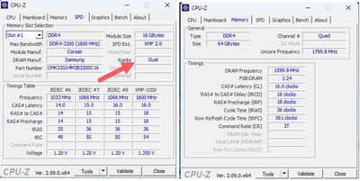

Here's the CPU-z output
Here is slot 1

That is the correct dual rank memory.
Do you have the original HP memory?
try the original memory in each slot.
if the slot has a warning that it must be filled first, then put the original memory in that slot and one of the new ones in the second slot.
if the slot is defective then return under warranty else the memory is simply not compatible.
The image from that wmic shows no memory part number.  I have never seen that and I have run through a lot of systems.  Possibly the HP bios cannot identify the the memory properly but somehow can use one of the memory.
