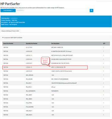

Hi Erico, Thanks for the feedback.
I was able to get the serial number, product number, and description from the PartSurfer. It had no detail on the Component BOM dropdown.
Product Number :  3JE06AV
Description :  HP W/K PHTM 13t-ae000 CTO1 BNBPC

"I was able to get the serial number, product number, and description from the PartSurfer"
The HP PartSurfer does not provide the serial number.
It is your responsibility  to provide it to the PartSurfer.
