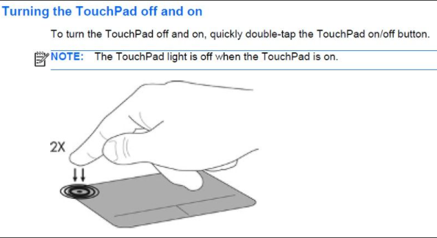

The little orange light is lit up on my touchpad - then my pointer stopped working. I do not use a mouse.  I didn't know how to get pointer working again so I shut off computer.  What do I do the next time this happens?
Hi,
The laptop orange light LED is indicating the touchpad has been turned off - this is usually a simple on/off toggle that is activated or de-activated by double tapping the corner of the touchpad where the LED is commonly this is the top left corner.
