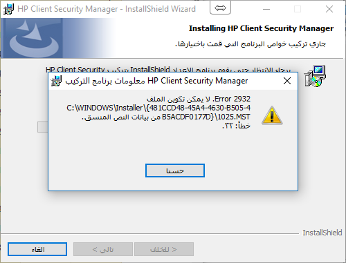

Sorry but I have another error while installing, if you can help me. 😞
Thanks again

This is not the initial topic of the post and I did not run into the same issue.
But sounds like a problem with the Windows Installer, not from the HP Client Security Manager. You should found solutions if you search for the Error Code 2932 displayed. For example deleting the speicific directory shown in your picture is one solution I found (but without guarantee 😉
Hope you get this solved.
