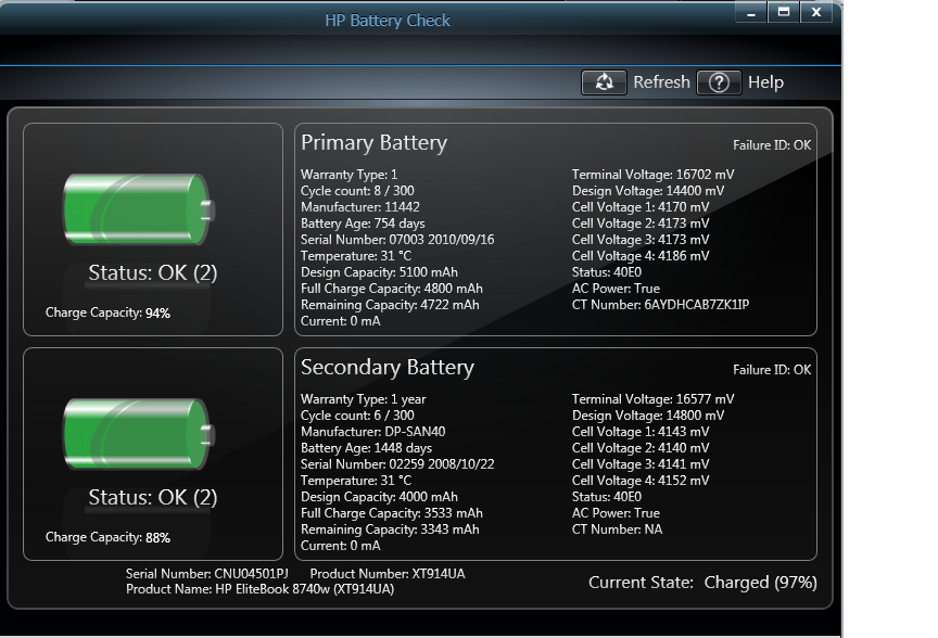

Also a quick note for the geeks out there , use the "Battery Health Check" of HPPA in the Preferences Tab and use " Settings "   button on the bottom left of this screen, change this to ADVANCED then it shows some VERY useful information regarding the battery , like how many times it has been charged and its capacity new and its capacity on last test etc in mAh.
( This can also be accessed via HP Support Assistant via TROUBLESHOOT / POWER, THERMAL and MECHANICAL and there is a link for BATTERY TEST. )
Remove AC adapter and run battery till flat ( also remove secondary battery if fitted ) , turn off sleep/hibernation/power saving  etc so system crashes and battery is totally flat. Refit AC adapter DO NOT REBOOT let battery charge until Battery light on PC goes out, not just until LED goes from orange to blue ,this took about 1 hr. Reboot PC and the " Data calibration in progress " bit on the first profile tab in HPPA should have now dissappeared.

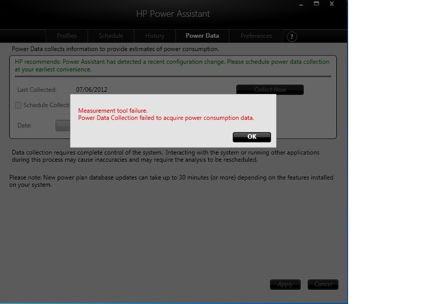

I also found a new HPPA version , 2.5.0.16 , on the US site , so I loaded it to see 🙂
Well everything seemed good no errors at first , no calibration bitz in HPPA , however still could not use the "Power Data " tab in HPPA and do the "Collect Now " button ,this returns an error saying Measurement tool failure , it does start to do the collection but fails after about  5 mins giving this error 😞 This is in a small box onscreen NOT an Event Viewer error.
So some advances but still errors, I have also tried this on XP and have identical errors , even with the new HPPA.
