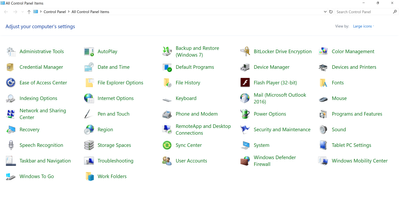

So I went into the control panel and didn't see an icon for Synaptics. Here's what I see
I tried going into the Mouse icon, in there I can get to Synaptics properties and settings but then there is still nothing there about scroll direction.

Hi:
Yes, my control panel settings look the same.  I don't have a pen and touch category because that notebook doesn't have a touch screen.
But mine has an additional category...a Synaptics Lux pad icon, and that is what is missing from yours.
