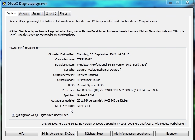

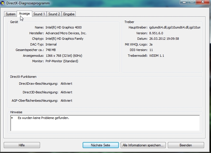

Can you do this please: when your HD 7650M is running, press WIN+R and type "dxdiag" .
Is 7650M displayed there?
Thank you a lot.

I ran Super Street Fighter IV (ofc. running on the 7650M HD) - in dxdiag it only displayed the HD 4000 (while running the game). < on the 7650M the games-benchmark indicates 60FPS (on VERY HIGH Settings) with the HD 4000 it manages barely 15-20 FPS)
Also Skyrim shows only the HD 4000 but it runs on the 7650M (settings on the screen can be set even higher and played fluildly (28 FPS).

Some Screenshots:
(Even when it is set to run dxdiag High Performance it will not show the 7650M).
