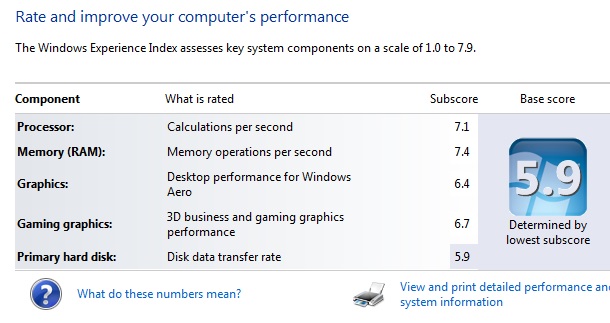

Our resolved 4540s with functioning 7650 only scores a 6.6 in the windows GFX benchmark.
When you say 'is notworking ?' .. can you give any clues, eg. have you tried installing passmark and checking the score ?
The main issue with the GFX card seems to be it's inability to turn on sometimes, and if it does turn on it's often detected incorrectly as still being the Intel integrated GFX card.
Benchmarking it and comparing the scores will show whether it's running or not, so please give that a go and reply again (with the scores) if it's still problematic.
