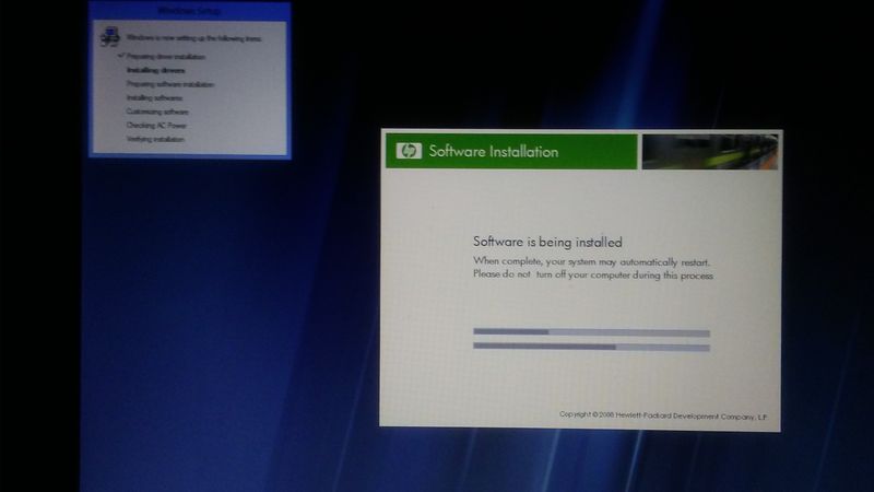

Here is the screen when it was installing the drivers which got completed.
Anyways it completes the driver installation, then it reboots to show the Administrator Login Screen, then it reboots again, probably two more time then I get the error screen
