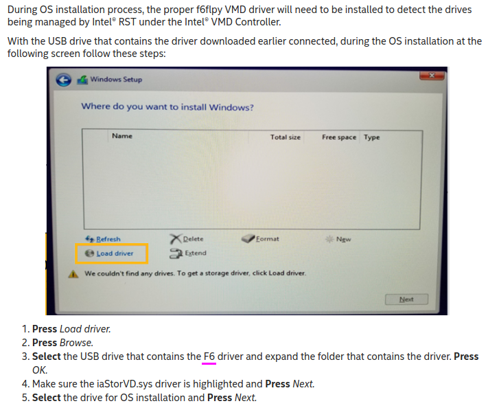

i am trying to install widows on my laptop but when i get to the part in the installation where you choose to install it there is nothing on the list. a warning comes up says you can't install on this device

(1) Download and run ( on another computer )
Intel Rapid Storage Technology Driver
17.11.0.1000 Rev.A34.2 MBJan 3, 2022Download
(2) Let setup install/extract drivers on your <USB flash drive> or use 7-zip to extract sp136828.exe file to <USB flash drive>. You will choose directory "f6" in step (3)
(3) Load driver in Window Setup
(4) Please report your results

When loading the driver you need to "browse" to the right directory that contains the F6 driver .INF files

For the sake of convenience Paul_Tikkanen EXPERT Level 21 has the  file "zipped up and attached that specific folder below":
https://h30434.www3.hp.com/psg/attachments/psg/OS/624052/1/F6.zip

The procedure Ub6424 posted initially was the correct one -but the driver was wrong. The whole problem is that storage on Tiger Lake cpus and motherboards is not natively supported by win10 and needs the special driver in the USB installation media. Kind of like in windows xp era with the sata drives.....  https://support.hp.com/us-en/document/ish_4859717-4859823-16 It should be working, all you need is the F6.zip by Paul_Tikkanen.  https://www.intel.com/content/www/us/en/support/articles/000058724/memory-and-storage/intel-optane-m...
