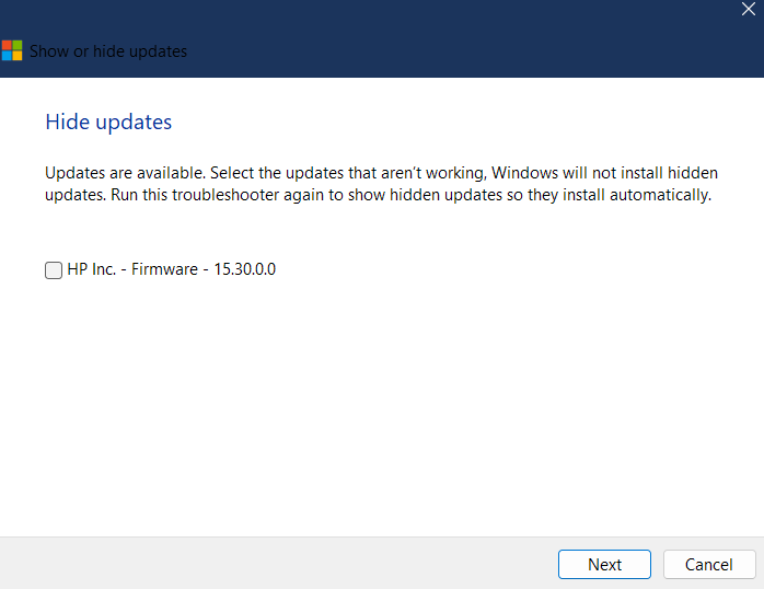

Alright, removing this "HP App Driver" under System Devices did indeed also remove the 2 others HP Software Components!
That said, the WUShowHide.diagcab didn't list any of these Drivers for me to hide them, it only showed "HP Firmware" (see screenshot).
(As instructed, I launched it right after removing HP App Driver)...
Isn't there a manual way to hide these drivers (maybe via the Registry)?
PS: it didn't also seem remove the 4-5 HP services in services.msc, I've disabled them but I again, they might re-enable themselves.
Thanks so much, and again your reply is theatrically-speaking the best answer 🙂
You're very welcome.
Unfortunately, I don't know of a way to disable the device if the Hide Windows Update utility didn't work.
I was a bit surprised that I could not simply right click on the device in the device manager and select disable.
I googled "disable hardware devices in the Windows registry' and there are some articles on that, but they are all over my comfort zone, and none seemed specific enough to get me to look into it any further.

Hi, @ub6424
The solution you referenced in your first reply does not work at all.
I clean installed W11 using the Microsoft tool and got all of that stuff back automatically without installing any HP drivers.
What you are right about is that HP has installed a specific hardware device that I referenced (HPIC0003) and a driver is automatically installed from Microsoft (even if you don't install the driver from HP), that monitors performance and diagnostics info.
I have not found a way to permanently disable it.
If a person wants to try and prevent that HP stuff from working, that's his business.
All I was trying to do was to assist and experiment.
The viable solution is to continuously disable the services, if necessary, from running in the Windows Services control panel menu.
