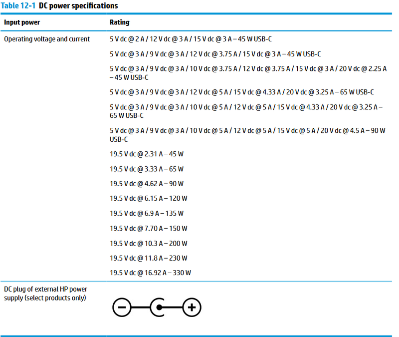

Hi, i have the same Problem with my Envy 15-ep0670ng.
The user manual says that it should charge with less Power than 200 W through the Thunderbold port.
I tried with a 20 V 5 A power supply from Anker wich should fit the requirements:Screenshot 2024-11-14 091322.png
