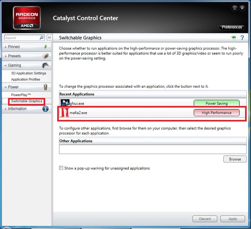

CCC is working and also I can set up whole settings but the High performacne is running always on Intel GPU.
Bellow you can see some photos:
that game has an option in the menu to test the performance, so you can see that is using Intel GPU with very low FPS...

If you mean change the mode in BIOS to fixed or dynamic there is no option to do this. I see in that attached document G6 laptop models which should update the bios to be able used fixed mode but my model is not listed there...
Regarding AMD gpu I have installed two different utilities ( cpu-z and furmark ) but they cannot recognize it. only Intel hd 4000.
