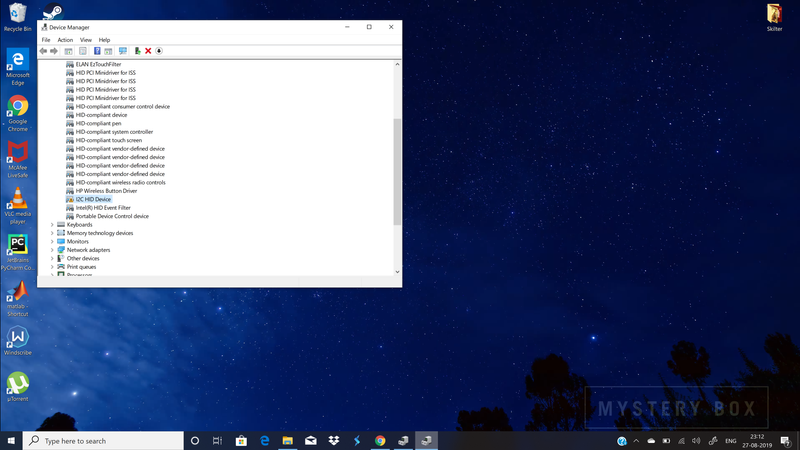

08-22-2019 08:30 PM - edited 08-22-2019 08:41 PM
I have found that the issue is due to the i2c HID device. It says, This device cannot start( code 10). A re quest for HID descriptor failed. I'll attach the images in this thread. My laptop was bought a month and a half ago and it's cover under warranty but the problem is I had bought it from US and even though HP says, it's warranty is international, I would also like to have confirmation on that. But most importantly, I hope you can resolve this drive issue before it gets to me going to the HP service center. So please tell me how to fix this?

08-27-2019 11:46 AM - edited 08-27-2019 11:50 AM
Hey .@The_Fossette
I'm sorry to break this to you but unfortunately, I'm facing the same issue again. Could you please help me out again?. I really have no idea as to why this keeps happening. I tried what you told me above and did it exactly like you told me to do. Now,even that's not helping me. What do I do? Why is this happening?
