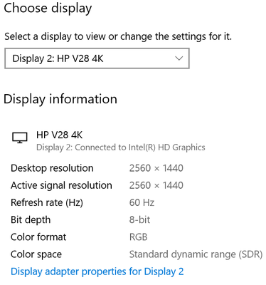

Hi Banhien, thanks for that. Advanced Display as below. Can't see anything with options for 30Hz - they all appear to be 60/59Hz...
Hi Banhien. Thanks for comments so far. Anything further? I've been an IT professional for a long time, but was never an expert in device drivers. So - to summarise where I think I am:-
1. I know my laptop/dock can function with full 4k mode (3840 x 2160) - I have seen it work at my old employer with an Iiyama monitor.
2. Given that the Surface 3 (although not necessarily its dock) can only work in full 4k 3840 x 2160 mode at 30Hz not 60Hz, I need to find a way of running the screen interface at 30Hz. Not ideal, but as I am not a gamer, and am more interested in getting static information on the screen than fast video, potentially useable.
3.  Going with what I believe is the most up to date driver file (from HP - as above) for my Surface 3 with windows 10 as up to date as I can get it, it appears that the setup (presumably the driver file) is saying that I don't have any available options to go to 30 Hz.
So - my question is - do I have any remaining options to get things to work in 4k / 3840 x 2160 mode?  To ask the question - it would seem strange, but - could I use a non-HP (generic?) driver to run at 30 Hz and achieve what I want without causing other problems?
Any other advice / suggestions welcome. I'd be reluctant to return the product.
Thanks
David
