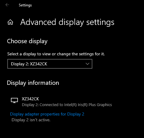

This week, I received my new Acer Nitro XZ342CKP monitor. I tried to connect it to my laptop as usual, using HDMI cable to its HDMI port, but it shows no display at all in the external monitor, like if it is disconnected. When I go to Control Panel>Display, I can see that the machine recognizes the monitor, but that's all. I tried checking the external dispaly adapter properties, but it shows "Display 2 isn't active". When I go to Intel's Graphic Card software, and I try to enable this external display, nothing happens.

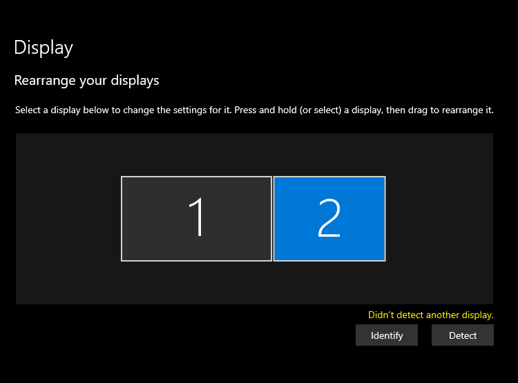

As I stated previously, I connected the monitor to my old laptop, using the HDMI cable the monitor came with, and it worked fine; yes, at a lower resolution and just 60HZ, but I was able to expand and mirror the image from the old laptop. Now, when I do the same with this monitor and the HP 15, this occurs:
It recognizes the monitor, but at the same time it doesn't.
