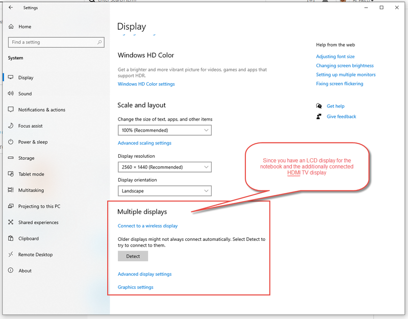

I have selected "extend" under presentation modes; in fact, I don't have to click on anything, it is the mode in which the laptop operates when I plug in the monitor, and I verified that the mode is still selected when I have the TV plugged in.
The ProdID is 2FH30AV. I looked up HP EliteBook 850 G5 and see a spec sheet that says this model does have RX540 and 2GB GDDR5; I am not sure how to tell about these latter two items on the laptop itself, nor how to tell about "Hybrid Graphics".
To re-state the problem (hopefully no new information here):
Since you have pointed to a dialog that mentions wireless displays, let me make this clear: I do not try to use the monitor and the TV at the same time. When I am upstairs in my den, I plug the monitor in with an HDMI cable to do computer work; when I am downstairs in the family room, I do not have the monitor plugged in, and the problem I'm attempting to solve is that, when I plug the HDMI cable from the TV into the laptop, the television displays a message saying there is no signal. When I click on the "Detect" button in the "Multiple Displays" dialog, it says no additional displays are detected.
I can use that SAME HDMI cable, unplug it from the laptop, and plug it into a different (Windows 7) laptop, and the extended display to the television works fine. So I am confident that the HDMI cable I'm using works, and that the TV is set correctly to use its HDMI connection. Since the laptop connects to a monitor out of its HDMI port, I am confident that the HDMI port on the laptop works correctly.
