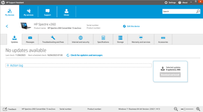

Hi,
Thanks for your reply. I already run HP Support Assistant and that tells me there are no updates available. I have also installed Intel's own direct equivalent and that tells me it's all up to date as well.
