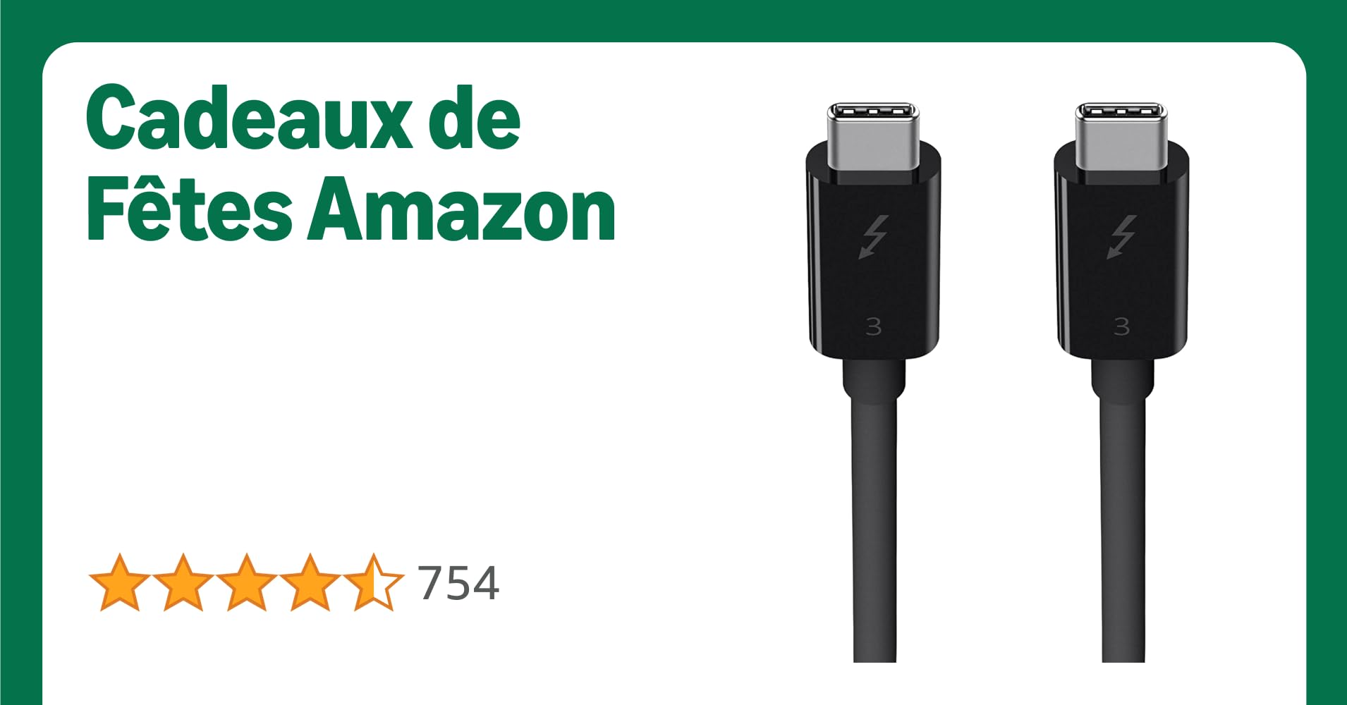

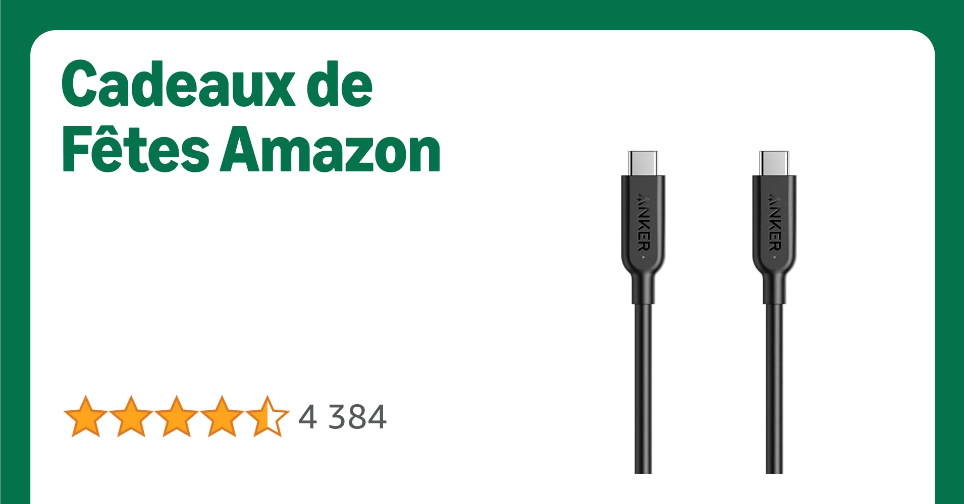

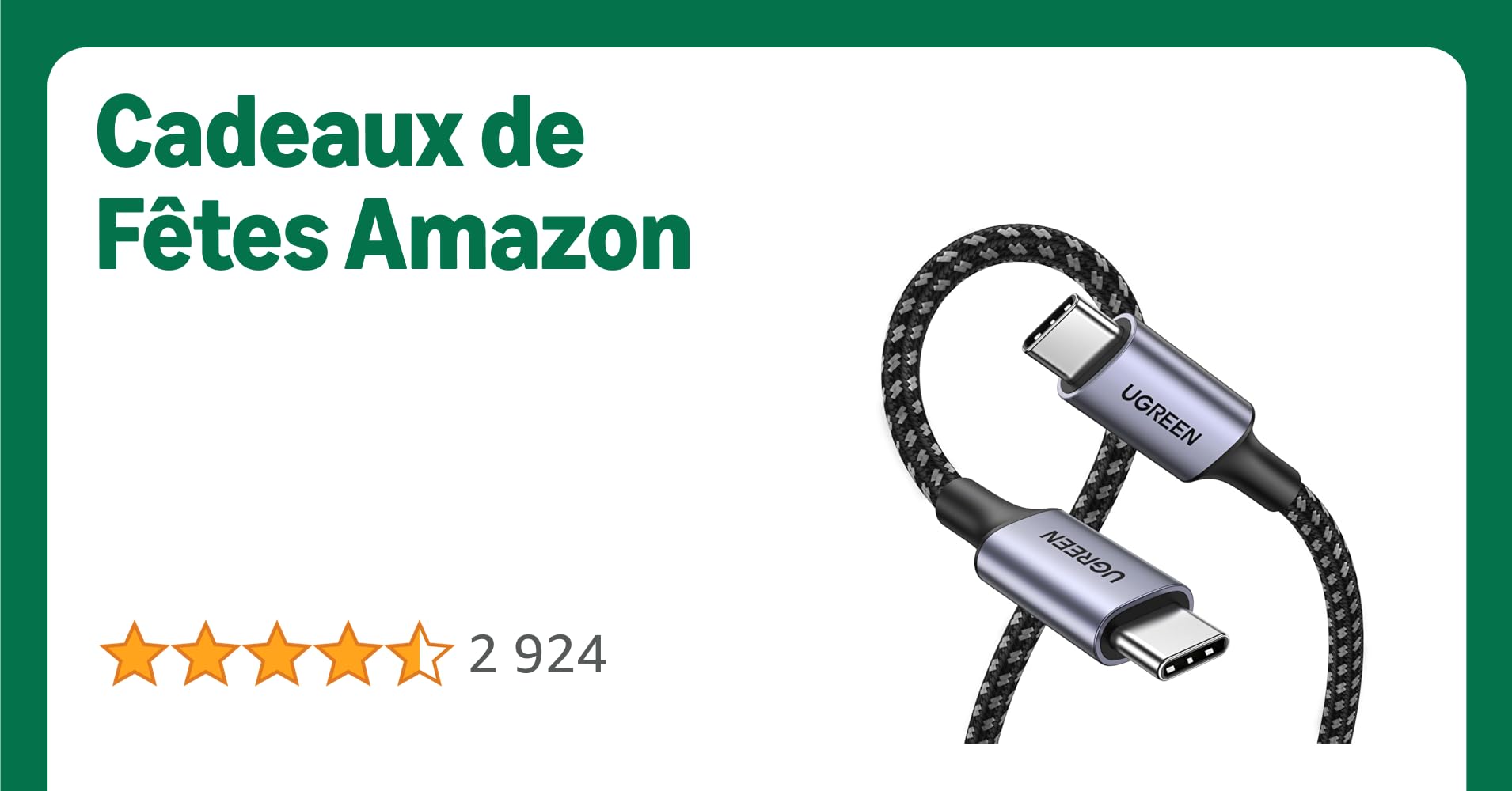

I tried this 3 refereces in this way :
Apple Thunderbolt 3 cable
https://www.amazon.fr/gp/product/B0725DW6D3/ref=ppx_yo_dt_b_asin_title_o02_s00?ie=UTF8&psc=1
https://www.amazon.fr/gp/product/B072JYDQ7N/ref=ppx_yo_dt_b_asin_title_o01_s00?ie=UTF8&psc=1
https://www.amazon.fr/gp/product/B01EMIIFCU/ref=ppx_yo_dt_b_asin_title_o00_s00?ie=UTF8&psc=1
But with the 3 cases, i had the same issues : the vidéo signal pass well but my macbook 12" was charge only at 15w instead of 60w.
Can somebody help me to find the cable who will finally work ?
I wanted to try this one but i don't know :
