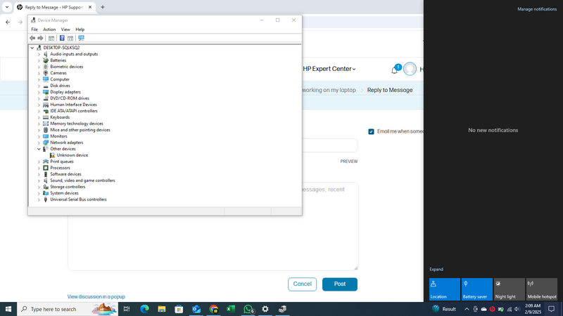

dear sir, thanks for your reply i have checked that unknown device the id of unknown device is ACPI\VEN_HPQ&DEV_0004
tell me about this now im installing the driver that you preffered

If that is the only device that needs a driver, you need this one for it.  It's not the Intel Bluetooth device.
HP 3D DriveGuard Software
sp64144.exe
Is there a Bluetooth device manager category in the device manager?
Have a look sir bluetooth option is not showing in my device manager im using pavilion dv7 hp laptop2025-02-09.png
OK...here's what you probably need to do:
The notebook originally came with W7 from HP, and someone upgraded it to W10 with the Bluetooth turned off with the HP connection manager software.
The HP connection manager software doesn't work on W10, so the Bluetooth remains off.
The only way to turn the Bluetooth back on without having to reinstall Windows 7 is to do this:
Make a bootable USB Ubuntu installation flash drive.
Here is the link to the Ubuntu operating system download:
Select the first one (Ubuntu Desktop).
Get Ubuntu | Download | Ubuntu
Here's how to make a bootable Ubuntu installation flash drive:
Create a bootable USB stick with Rufus on Windows | Ubuntu
After you make the bootable Ubuntu installation flash drive, boot from it and select the option to 'Try Ubuntu without installing.'
See if you can turn on the Bluetooth in Ubuntu.
Once you do that, exit out of the Ubuntu installer, shut down the PC.
Remove the Ubuntu installation flash drive, turn on the PC, and when you get back into Windows, the Bluetooth should be present.
If you need to install a driver for the Intel Bluetooth, let me know.
The main thing is to get that Bluetooth device manager category to show up.
Reminder: If you see a Generic Bluetooth adapter under the Bluetooth device manager category, it needs the Intel 1030 Bluetooth driver, or if another unknown device shows up, then that is the Intel Bluetooth in need of a driver.
