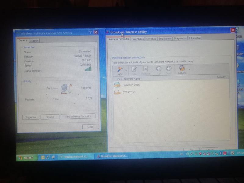

News:
I can indeed connect to free WiFi connections (no WPA-PSK things)and use them.But idk why I can't use my main WiFi router connection.If you have an email I can send images of the status.

It might not be a very clear image but:
CYTACD50 -> Main WiFi router conn. (WPA)
Huawei P Smart -> Hotspot I ran to see if I could connect to wifi. (Free)
I can browse the web whilst being on the hotspot.I might try removing the code from the router and then adding it again after connecting to it.
