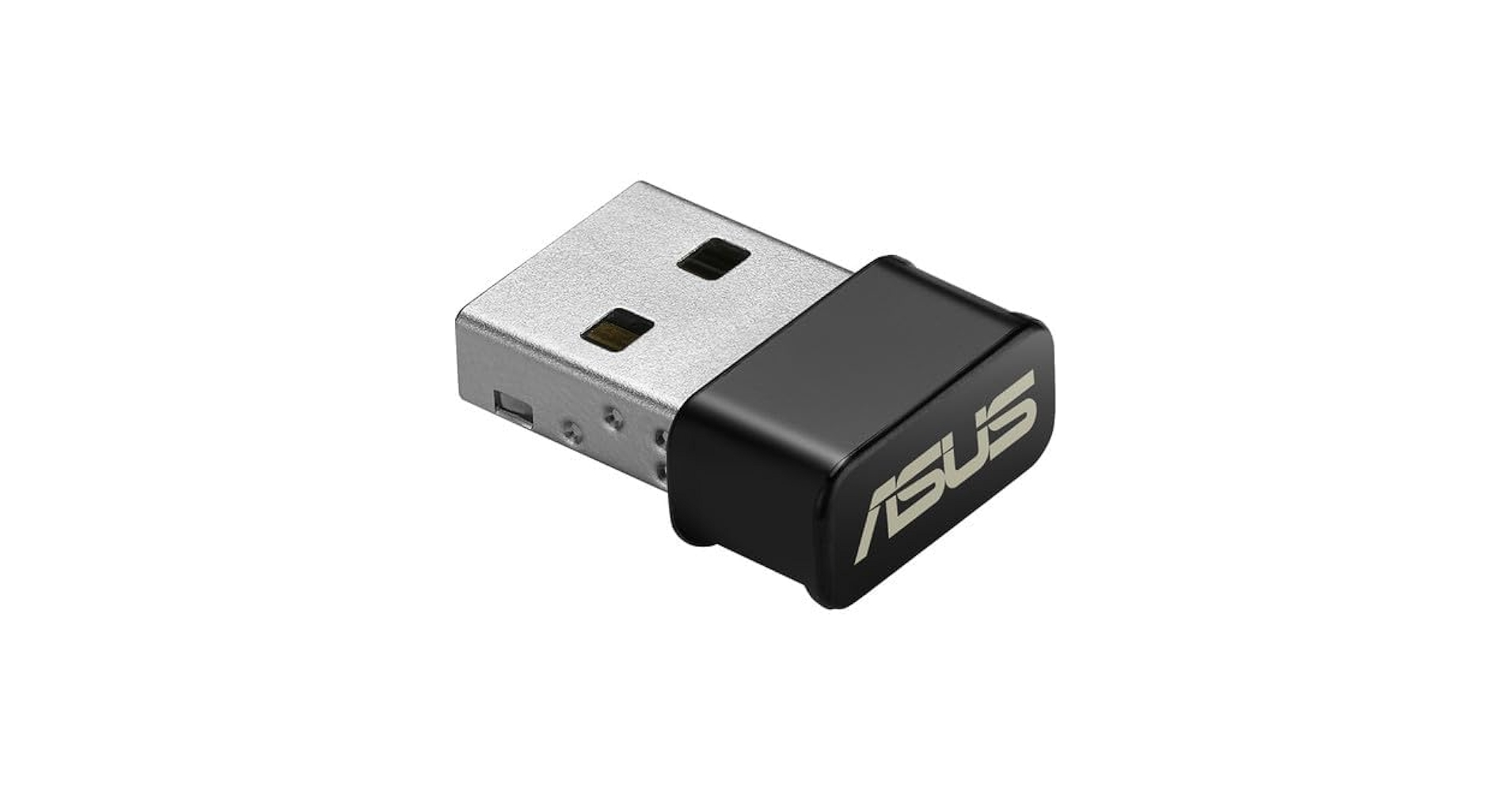

Hi,
To be able to navigate on the 5GHz network you need a Wifi module which can use the network. So an ac module. The best choice would be to buy a wifi dongle.
Example:
Hope it helps,
David
