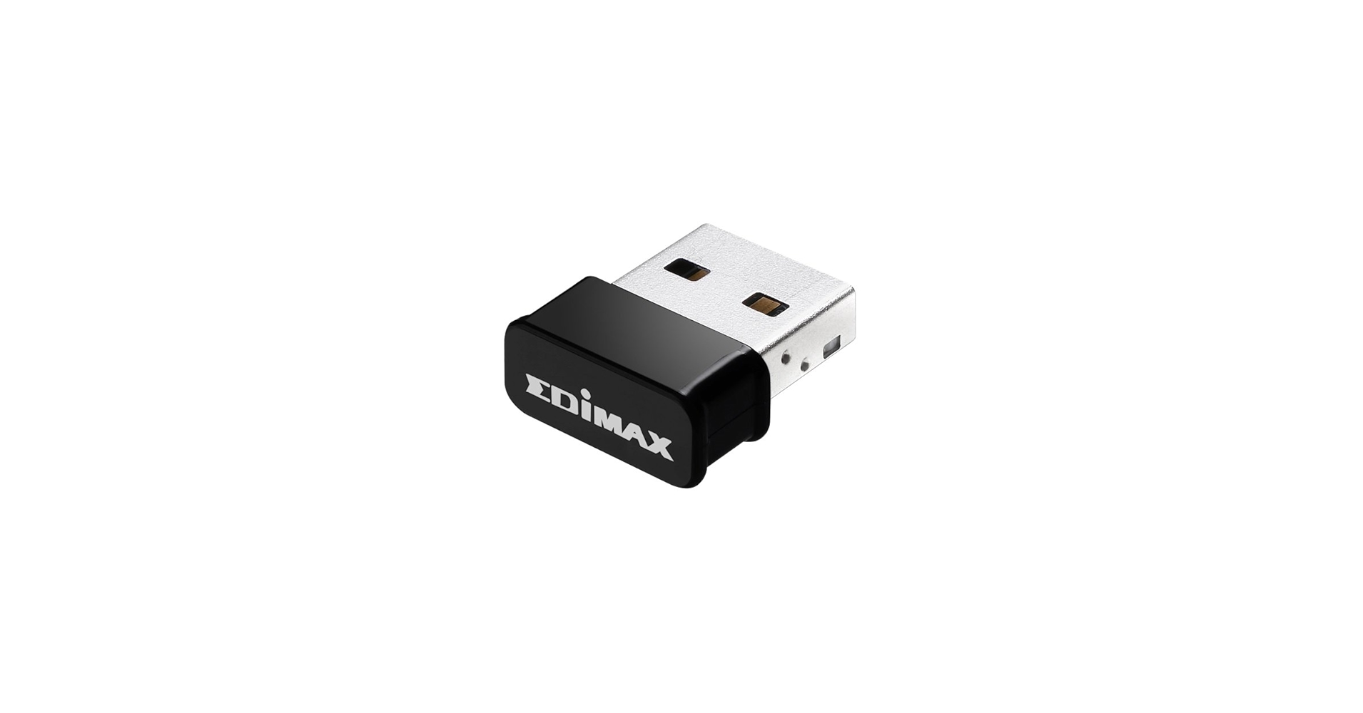

Went back to the original broadcom card and bought a usb stick for Wi-Fi, and that solved it.
Now the Bluetooth works as a charm and the wifi doesn't slow down when I am using bluetooth simultaneously.
I am about to buy a better usb wifi.
That edimax ac1200 you showed me works fine?
I like the nano factor, just hope the signal doesn't get too bad.
Thanks again
You're very welcome.
Sorry the 2nd antenna did'n't work (though as I posted the other day, I think they have to be matching cables and tranceivers).
Read the customer reviews on the Edimax device.  They seem pretty decent.  Seems the weak point is on the 2.4 GHz band, but you will be using AC on the 5.0 GHz band, so that weakness shouldn't matter all that much.
https://www.amazon.com/Edimax-Adapter-Supports-MU-MIMO-EW-7822ULC/dp/B01MY7PL10/ref=sr_1_1_sspa?ie=U...
