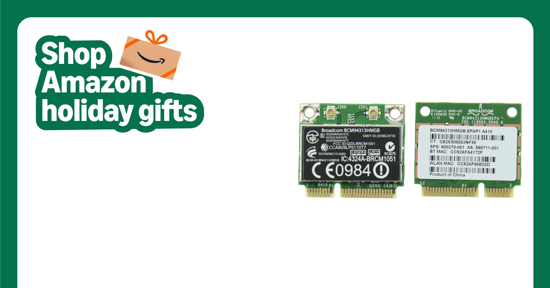

The card you suggest I might be looking for isn't available for international shipping from Amazon.com, but I've found one here https://www.amazon.co.uk/WIFI-WIRELESS-BLUETOOTH-BCM94313HMGB-600370-001/dp/B00VYLVQAM - It looks like the same card - would you agree?
And, by the way, I aint a Student! Can't find how to change that to 'Retired'!
05-15-2017 11:27 AM
The fact that the wireless card is absent from device manager is further confirmation it has died. Yes that card for which you provided a link is the same hardware and will work.

Huffer. Spot on! The part arrived today, fitted it (which, as you said, was easy), had to download the Broadcom Wireless LAN Driver - and connected to the world again.
Many thanks for your very clear guidance - greatly appreciated.
